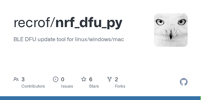

By the way, here are some more interesting MeshCore links for Linux users:
